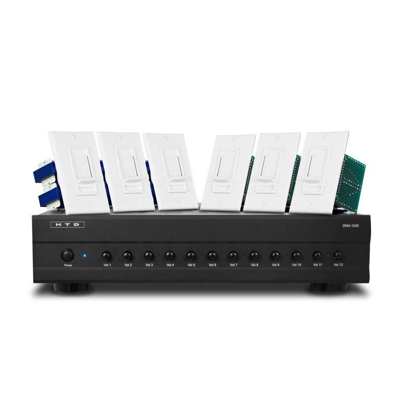

Hey guys! Its been so long since I posted here. Thanks for all your recommendations and advise above but I'm sorry to say that I've decided to ditch the wireless speaker setup.
I agree with @Wizardofoz, I don't think I want to keep facing wireless issues especially when the facility is crowded  :-\
My worry now is, now that I'm going with a wired setup, what kind of receiver do I need? Assuming I'm getting a 6ohm monitor speaker with potentially 40-50m cable run for the farthest speaker. Most of the mid-range speakers I see are 6ohms.
What I need is that music are playable without having to max out the receiver to achieve an audible volume. Music source is a laptop, using internet radio or spotify.
Source:
- Laptop using internet radio or spotify
- Don't need Hi-Res music
What I need:
- 9 channels
- Audible volume without having to max the receiver
- Weatherproof/Outdoor speakers due to dusty environment
- Preferably passive speakers (less worry for already long wires)
*Bonus, Not a full sized receiver, which I understand might be too much to ask for.
*Another bonus. Individual volume knob for each channel. So that other colleagues of mine can easily operate the receiver. Something like this
What I'm most likely considering:
- Belden cables recommended by @sydney
Help guys!!  :-[
Thanks in advanced!  :D

Hey brother Zaid,
Glad to hear from you again!
Ok, regarding your latest requirement, may I suggest something else?
1. Since the speaker is over 40-50m away from your source/amp, and it is going to be outdoor. Please consider those active PA speaker because they are more robust. Also with active speaker, you no need to worry which huge power AVR you need too because the further the speakers are, signal will drop too. Unless there are no power point at where you going to mount the speakers then no choice but to get passive speakers.
Check this link for the price and models for some ideas and consideration https://www.gearank.com/guides/powered-pa-speakers
2. Instead of a domestic AVR, please seriously consider a pro audio industry mixer, maybe one with at least 10 mono tracks to meet your need of 9 channels. But if you need 9 stereo channels, then you will need a 20-24 channels mixer. Bare in mind some are stereo channels. So find out how many mono or stereo tracks you need. By having pro audio mixer, you can connect any equipments, source and microphone onto it. And best of all each tracks has a gain & volume control for you to set. It is easy to use too once you set up.
If source from computer, then just output from the laptop analogue headphone port or use USB output to a mixer that has USB input. In this case, you can set your volume from computer, mixer or even at active speaker. You can blast the entire industrial park liao  :P
Check this out for some ideas http://www.wirerealm.com/guides/top-10-best-audio-mixers
3. Speaker cable just use Belden enough. Cheap and good.
All and all probably cost less than $2k if you buy brand new. And likely less than $1k if you buy used  ;)
Do not hesitate to ask if you have other queries.
