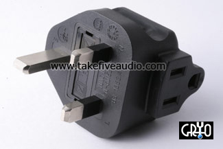

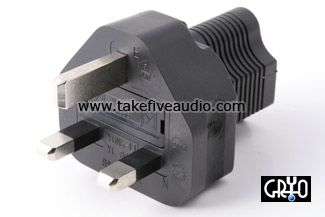

As for US to UK Plug adapter -> I buy from this site before, their polarity is correct for all that I buy (straight and angled versions).
http://www.takefiveaudio.com/mall/shopdisplayproducts.asp?id=82&cat=AC+Adapters
The other thing to be careful about these product is: think their fuse is the 5A 230-40Vac type.
Therefore after received have to change - propose to change to "Bussman Ceramic Fuse".
Bussman fuse can be purchase from RS Components SGP at very cheap pricing MOQ is 10pcs @ SGD 0.374 per fuse.
(RS Stock No.412-605, Manufacturer: Cooper Bussmann, Mfr. Part No.TDC180-13A).
YET to manage to find the same adapter in Taobao (they should have source from China, where else).
If Taobao have, will save on unit cost further as well as shipping cost.
